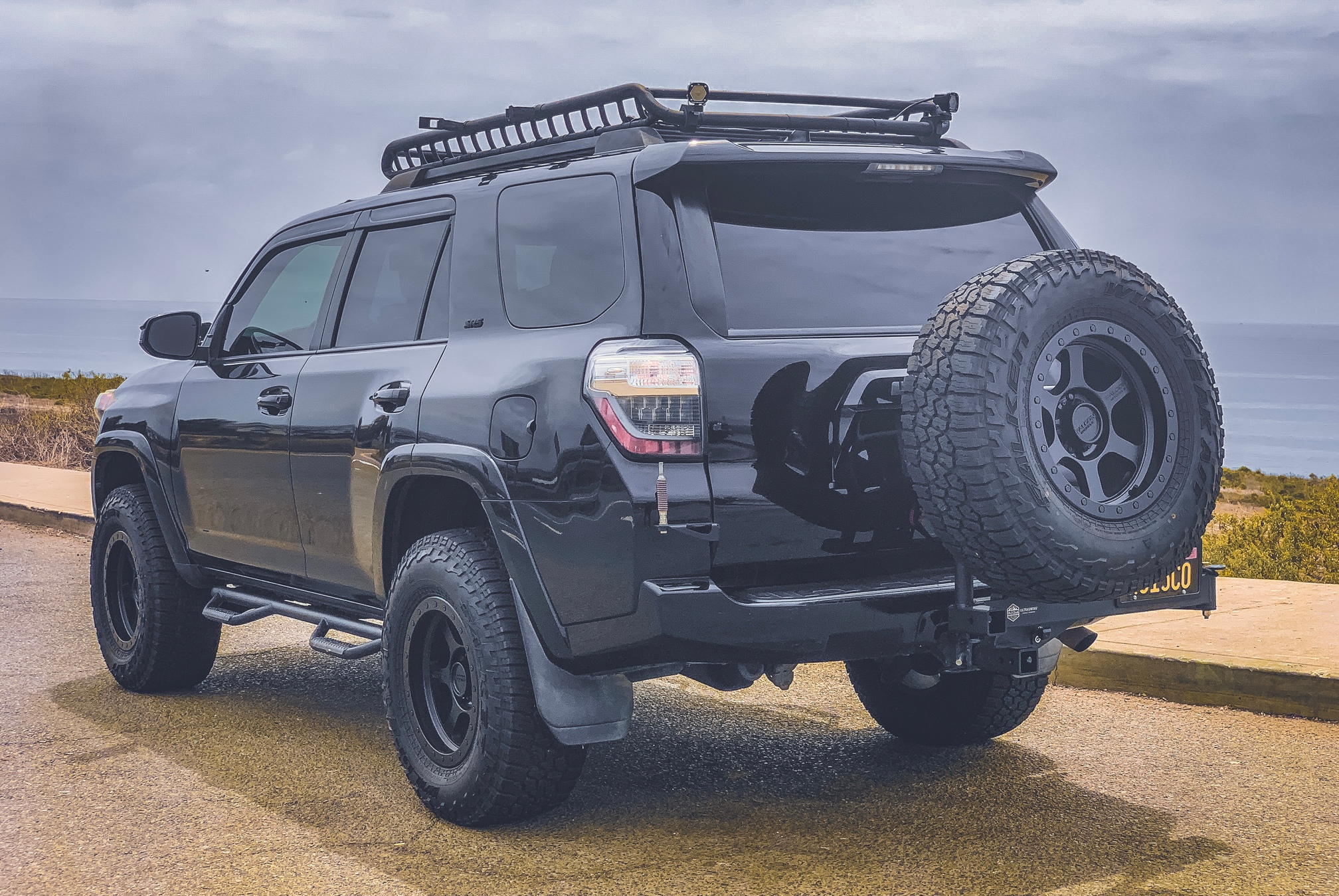

Hey guys, I just got my Ultraswing last week and definitely love it, but I did notice pretty noticeable bouncing in the back when going down washboard type (lack of better words) roads or freeways. I do have Icon 2” springs with 2.5 Resis non adjustable shocks in the rear. Anyone have a similar issue and find a fix for it?
