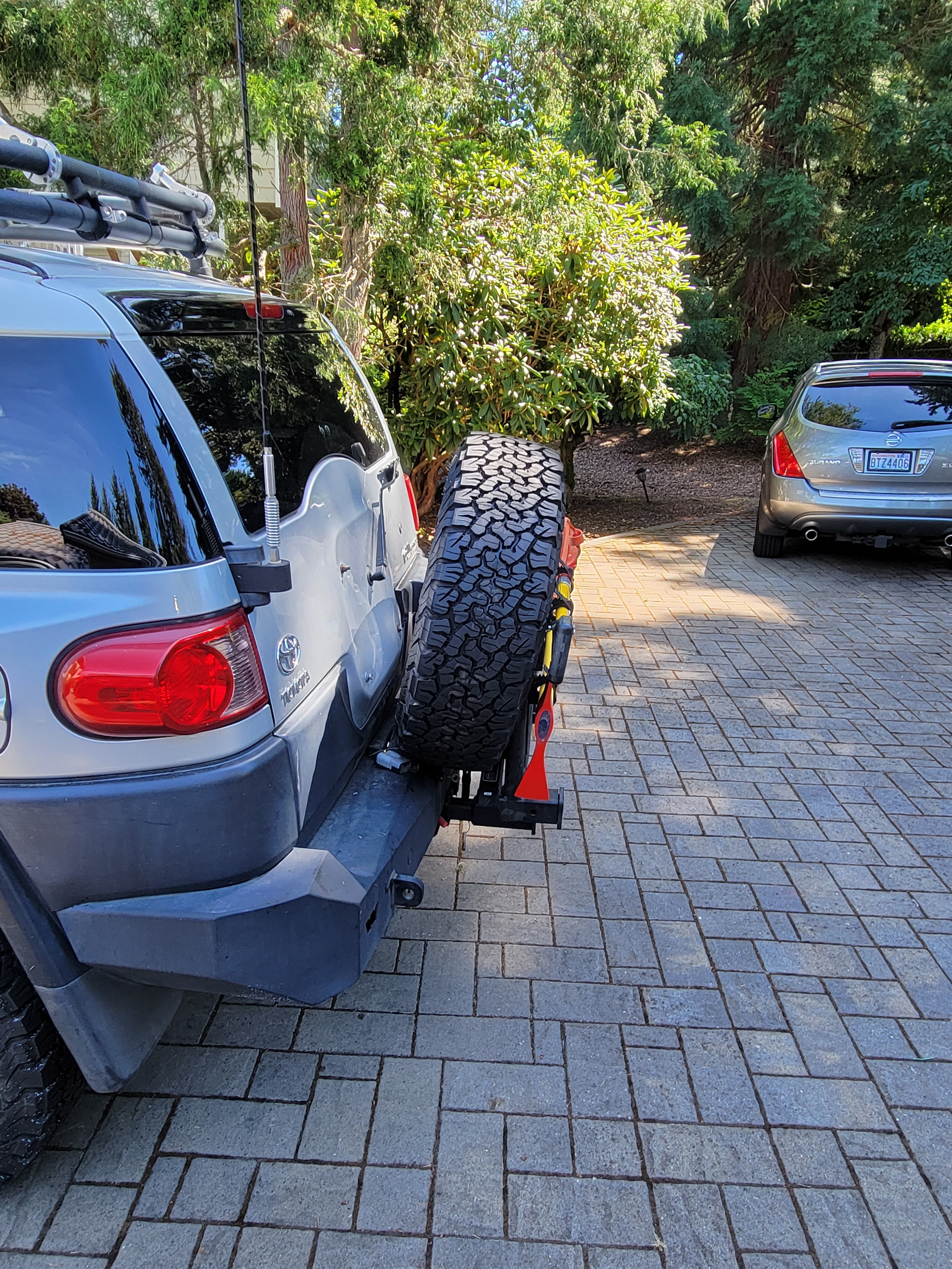

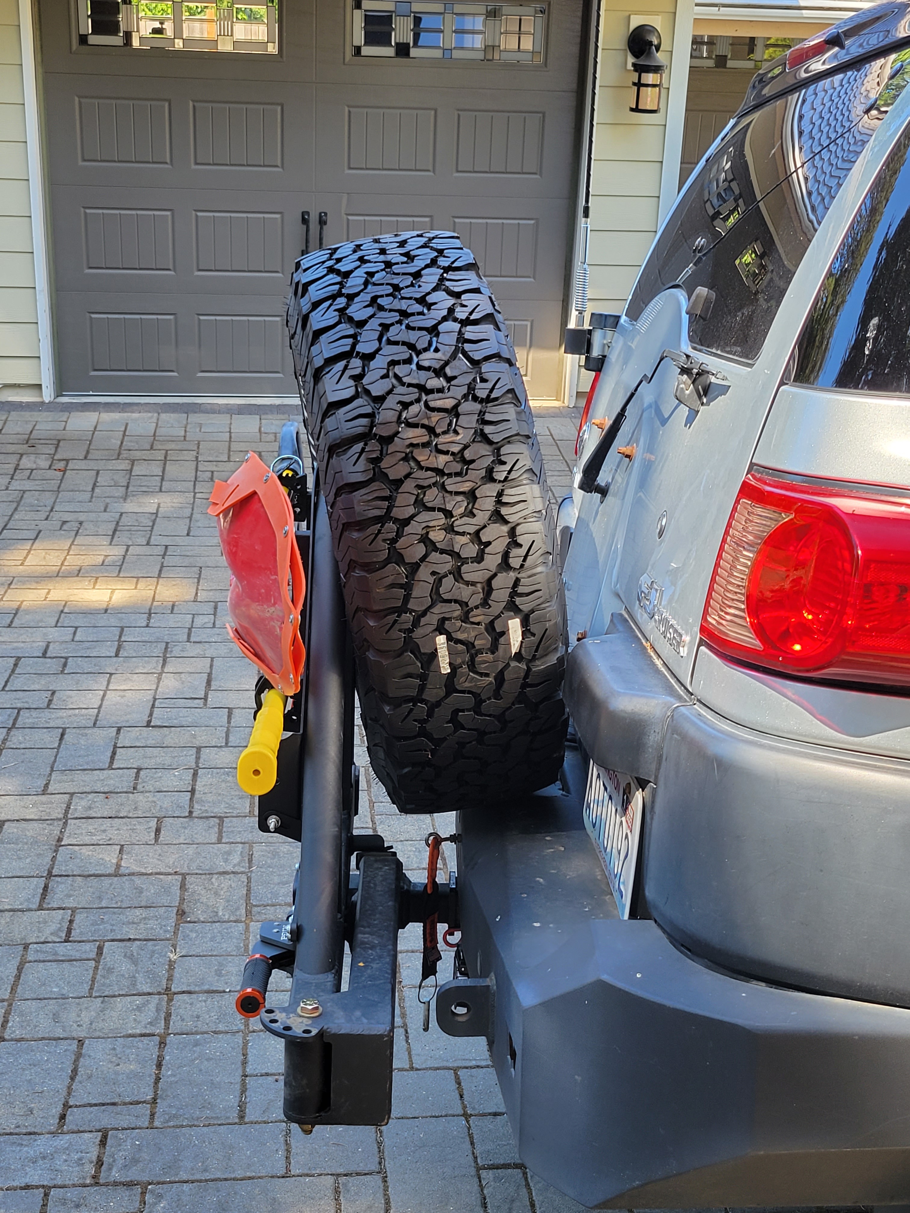

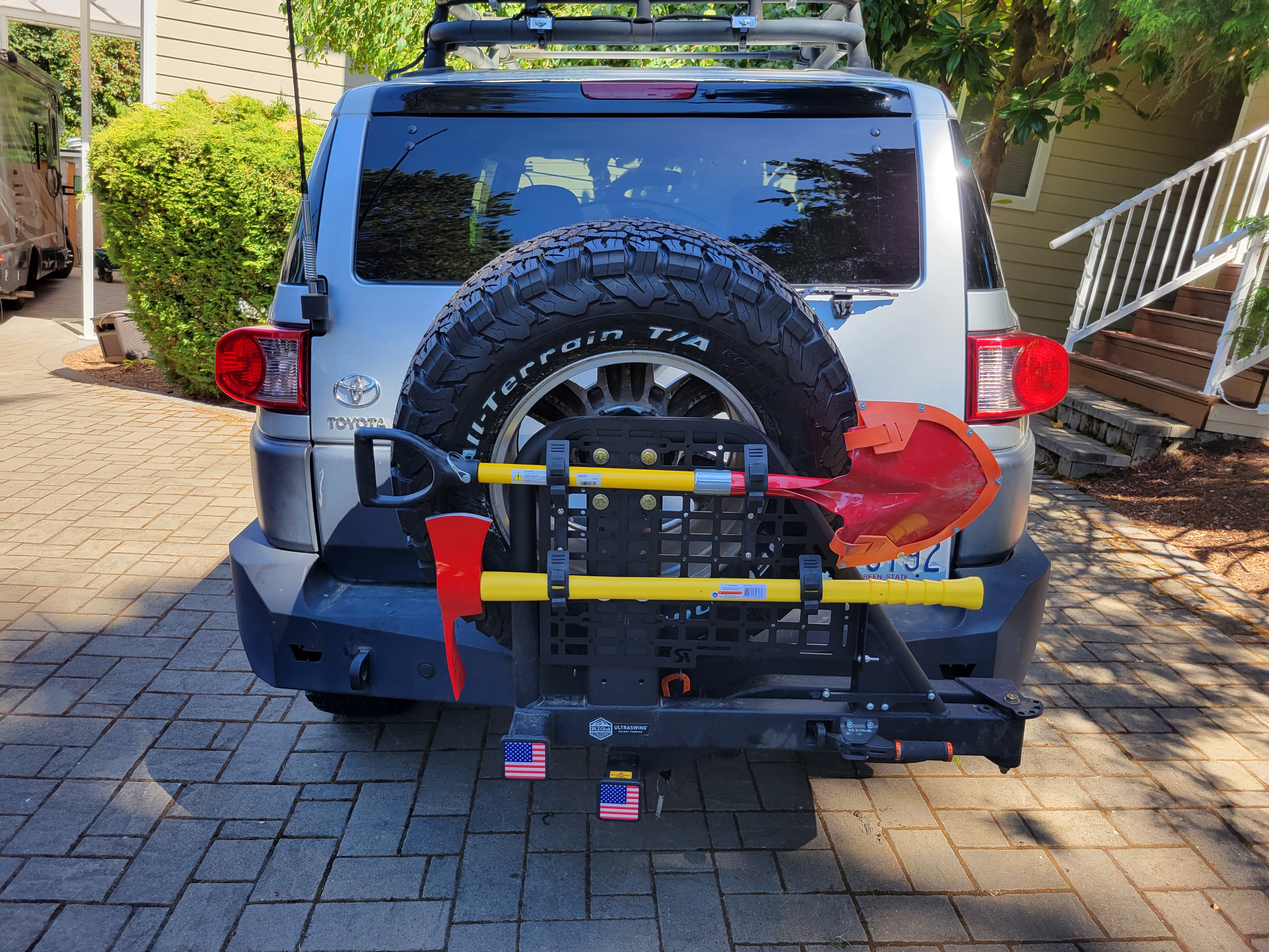

I have an FJ Cruiser with an Ultraswing. I tow an overlanding trailer that requires a high trailer hitch. The hitch interfered with the tire mounted in the conventional way on the Ultraswing. My son and I realized that the tire could be mounted on the backside of the Ultraswing, and would clear the hitch. I added a molle panel to carry a shovel and pulaski. The result is shown in the pictures.
