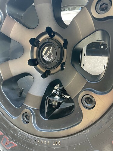

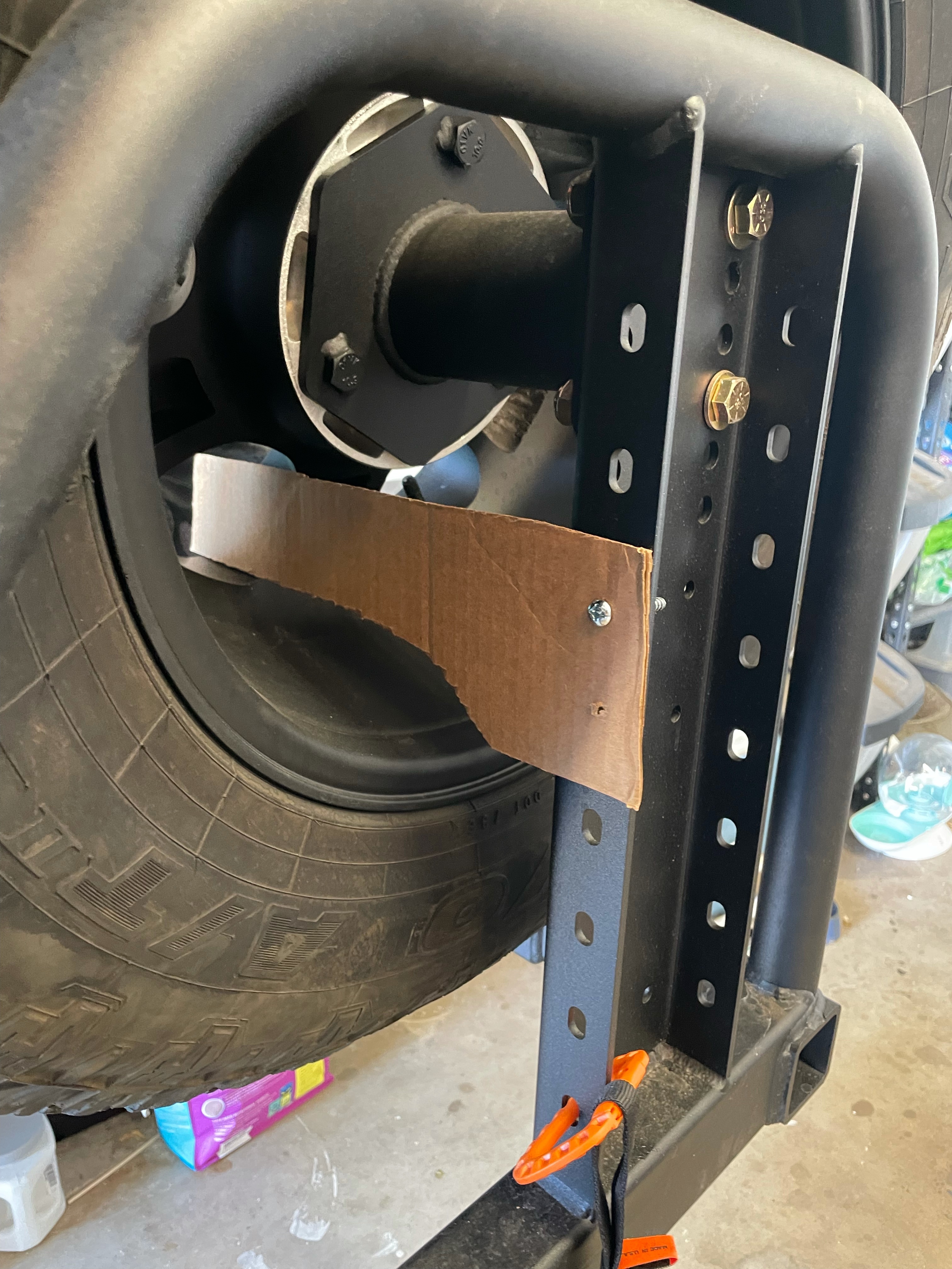

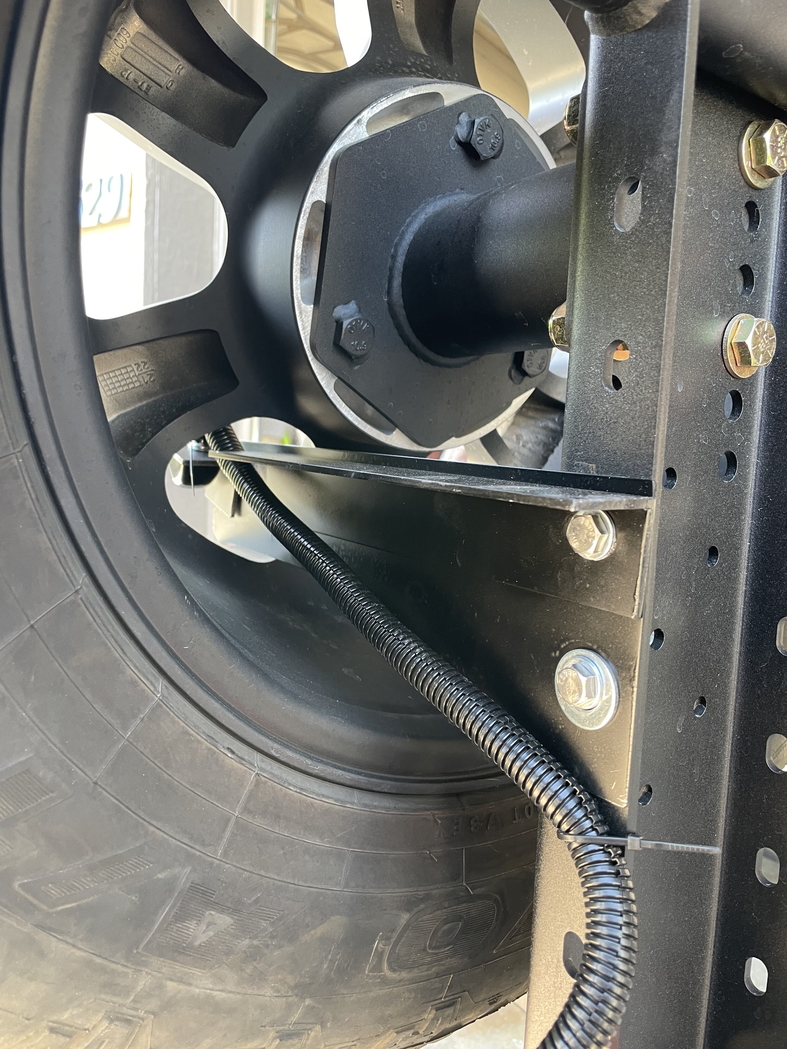

I used some Cardboard design skills to fab up the position of the bolts and what would fit through the gap in the spoke pattern of my wheels. You only need about 1.5" square of clearance for the camera to poke through.
Cutting to shape, I wanted to make sure I caught 2 bolt holes on the back of the tire swing. My initial design worked but was a bit wobbly. I didn’t want to risk it vibrating a scrape on my wheels in case it did come in contact. I added a top support beam of the aluminum angle iron. I dont have a welder so aluminum paired with the gorilla mount tape was perfect. Im sure 3m VHB 1" wide would work too.
Hit it with a rattle can of black and its solid.

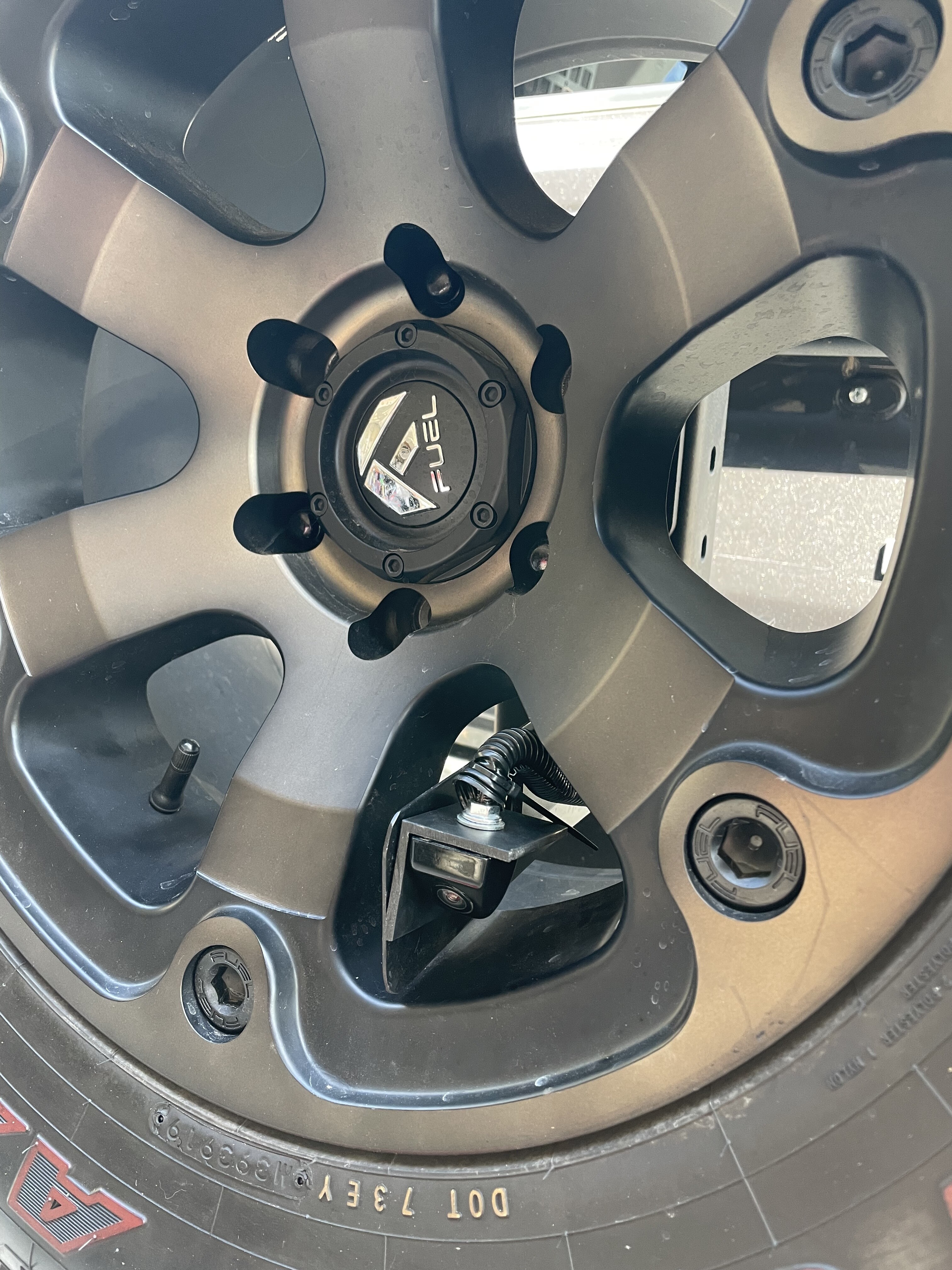

For the camera mount, I used some small clamps to test the positioning. It was decided to angle it up a bit. So I cut a 2" section of the aluminum angle bar to be at a different angle than the top supporting piece.

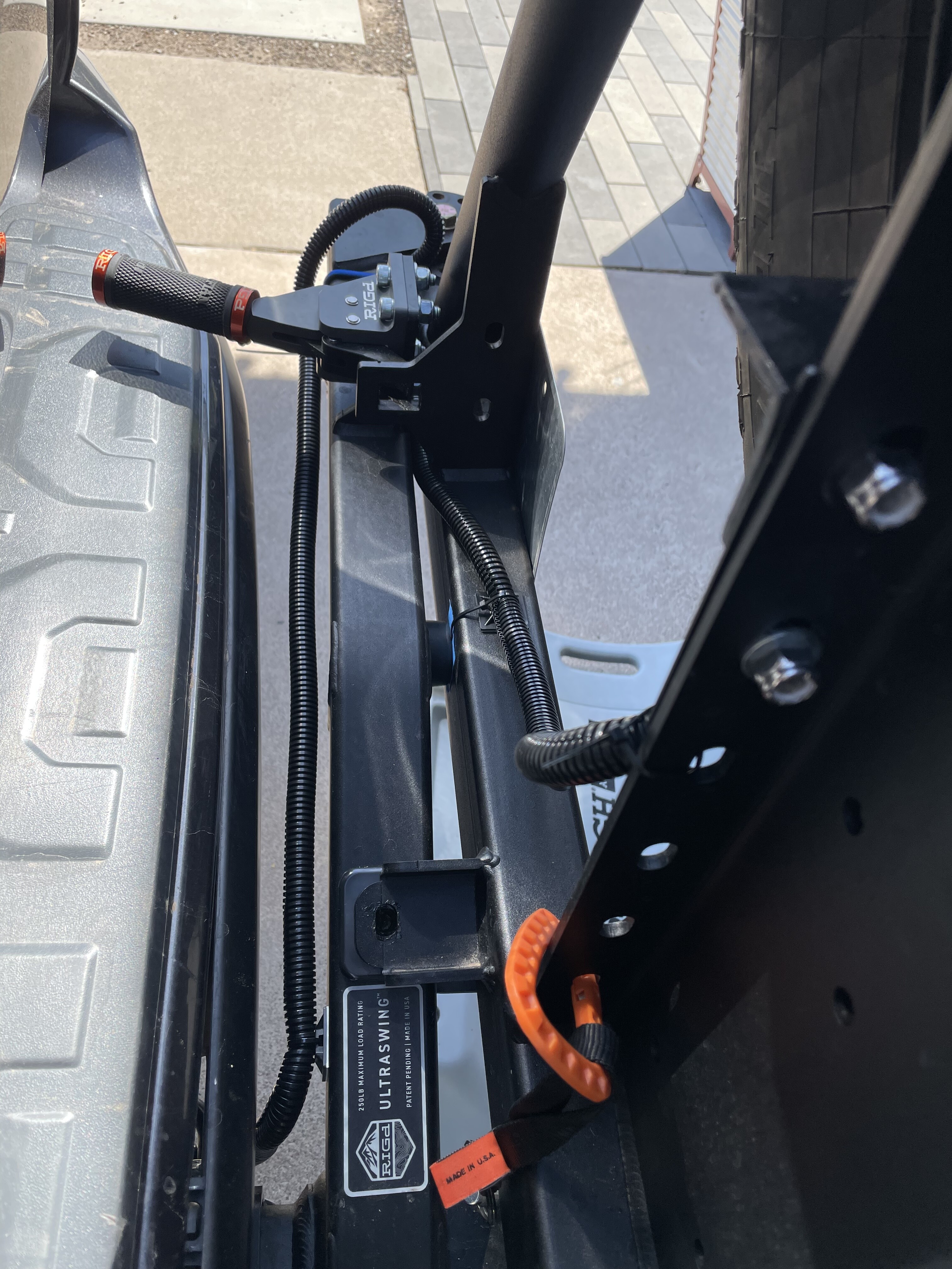

Using the black cable protector, I used some adhesive ziptie mounts to position it along the swing arm with a little play at the hinge. I ran across the top to keep it from catching anything when offroading.

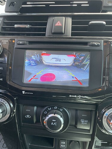

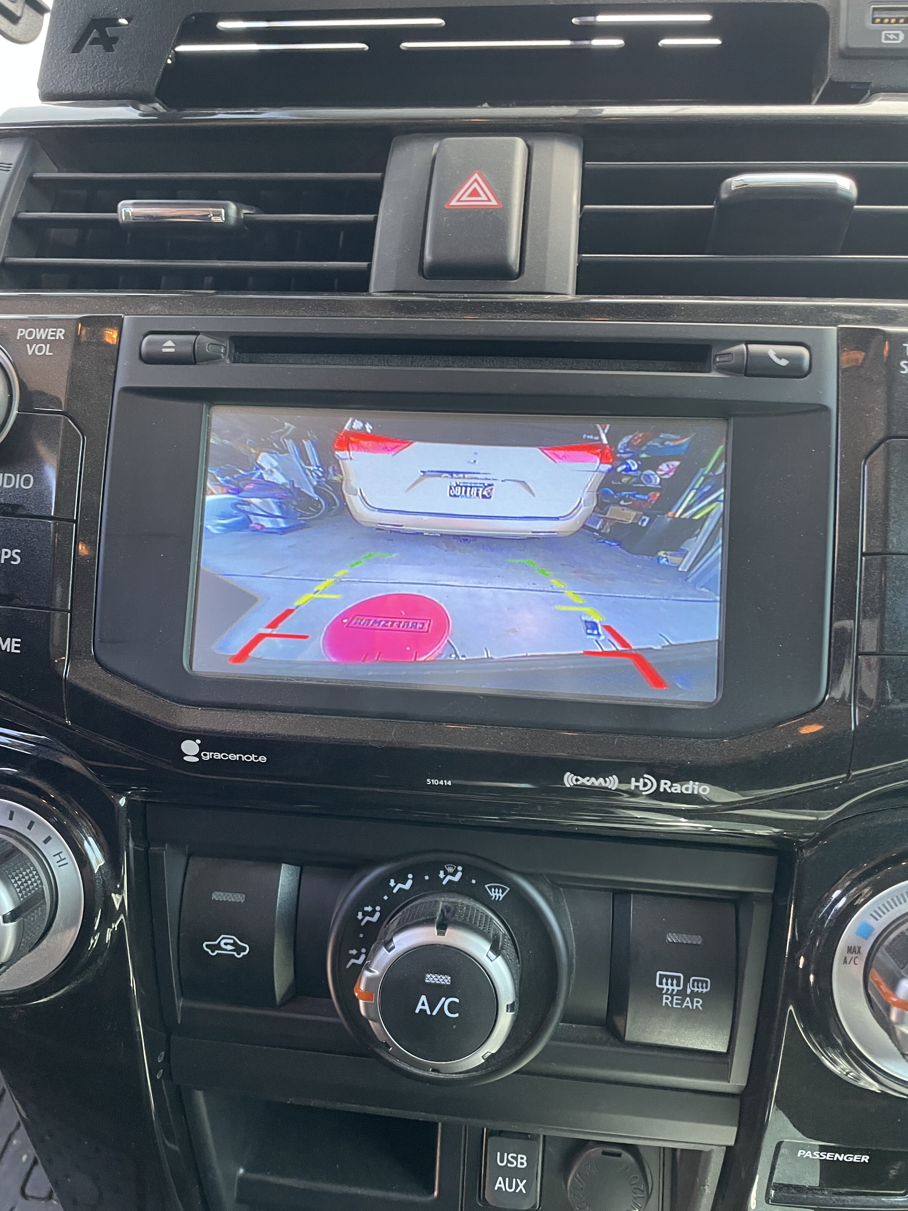

Finished product
